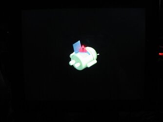

    Here is a photo the recovery screen I described above. Any one seen this before? And the 2 minute timeout/reboot is unique.
    Note the lack of text in the recovery screen.

    Yes I just switched the recoveries over to cwrm recovery so fast I didn't really notice.

    LOL, had to switch back to stock recovery to check it. Turns out, that's way my neighbor wanted it any way.
