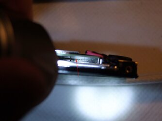

Here is pic of the place the factory designed a sim card to go it is right next to where the memory card holder is. In the pic the red arrow points to the underside of the circuit board and what I believe are solder trace points for a surface mount sim card holder. Cannot tell for sure as you would have to unscrew the circuit board to be certain. Otherwise you would do what Zorrobyte suggested and install the no solder ribbon cable setup, the only problem I see with that is you would have to have a dedicated sim card installed in the device then and not use your phone sim card as it is just not easy enough to open the device to install the sim card when you wanted it. If you where to have it full time it would be fine. One other problem is phone software for 3.2, it is in 2.2 devices but I dont know if its available in 3.2 and Iam not bright enough in computers to figure that one out so somebody else will have to. You would also need to dremel a slot in the cover for the sim opening similar to the memory card slot but that is pretty simple. At this point I have returned my a100 and will wait for the samsung 7.7 which supposedly has every thing already in it, but I hate having to wait and with the ongoing fued between Apple and Samsung I am worried the 7.7 may get shelved. In either case it will cost a lot more than what this does. I am satisfied with the screen resolution and brightness the wifi sucks and with that the gps for me is useless, so unless I can get it onto 3g or 4g it will not do what I want which is making me sad at the moment as it would do everything else I wanted it for. I somebody has an answer to the phone software problem post a reply here as that may change my interest as the rest I think I can do.
