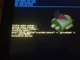

Hello,
I`ve tried last evening to proceed like your instructions, but when I tried to install the new rom, the process was aborted by the tablet.
Please see attached the message.
It is any posibility to backup the curent ROM before update to the new firmware? Can you please describe the process for the backup?
Thank you for your support and I apreciate your effort to help us.
Best regards,

Hello,
Best regards,
DanielView attachment 9102
Hi, could you tell us the firmware your using for upgrade? Which file your using and what firmware your running at the moment, thanks. The problem is in the firmware update your using "getprop" is a script in the updater used to check the firmware is going on the correct device, if its a custom rom they forgot to edit the script, let me know answers to questions above and will sort it for you.

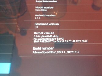

anyidyoulike
Nov 22, 2012
Hi, thank you for your reply. I`ve tried the V971D_v2.0-JB1113 firmware. Any news regarding the backup of the curent ROM?
