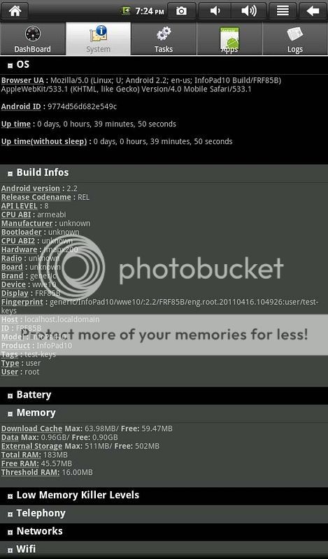

Im running 2.2 Froyo with Flash 10 from XDA guide, using USB Flashing.
And my GPS is working after updating to 2.2 Froyo.
