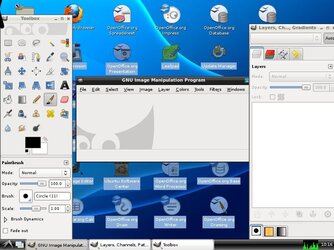

It worked. Runs really smooth, actually.
Had no issues with getting it setup, it literally took 3 minutes after the file was transferred to my extsd.
Everything I've tried works. Gimp, Open office, browsing the web, etc. Kind of makes me wish I could do a native install.

I'm the guy who got Ubuntu 10.10 working on his Kyros MID7022. I didn't like the look and feel of the package you can get from the xda-developers thread, so I've changed it somewhat, by setting up a new wallpaper, getting rid of most of the icons from the desktop, moving the bottom panel to the top, and creating a launcher on the left which auto-hides when not in use.
Here's the desktop when the left panel is hidden:
... and here's the desktop with the panel visible:
