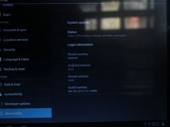

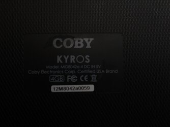

here are some pictures..

@vampirefo. ive never seen the last post.sorry sir.what should i do with this??:

@vampirefo.: In his defense, the model on the back says "8042a". The model on the about page tells this story. This clearly is an 8048.
@sirpercy: You have an 8048, regardless of what it says on the back.
