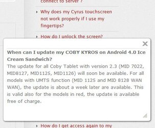

More news on Consumer Entertainment Products for Home, Office or On the Go! | COBY
more details on: Consumer Entertainment Products for Home, Office or On the Go! | COBY
If MID1125 can get ICS, it's very good news.
But I've read already some complains of HDMI not working.:(
