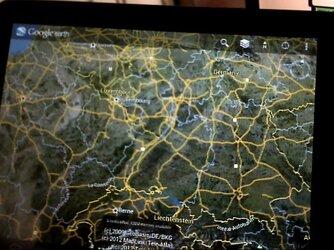

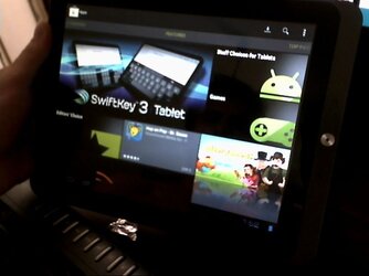

I did a more straight on aproach, for my mid 1126. I just downloaded the updater from coby germany website installed it and done the update. After that I saw that all my applications (including the Google play store and Google Earth) was still installed except the two mentioned were not working again. After that I decited to repeat the process of installing the gapps. I took the SD card from my phone and put the newest gapps zip file on it (Goo.im Downloads - Browsing gapps). Then i turned my tablet on while pressing the volume down button to enter fastboot mode. Then I installed the gapps from there (i used the MID 1125 recovery image that I found first time when I installed the gapps, after first upgade to ICS) (there is a little bit of cmd prompt tinkerig) . After that I restarted the tablet and now I have fully working gapps on it including Google maps, Google earth, Google play store etc.
After a first look I can see that coby did some memory and cpu optimization (my tablet is a bit faster :D) also my ui animations are not laggy like before and I do not have wifi connection problems.
