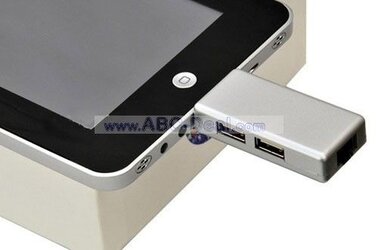

    hi, you could try plugging a usb mouse into the attachment that should have come with it, the one that has 2 usb ports and a lan port. my unit came with a silver one, and it looks like this

    yes i could do that and it works, but it defeats the purpose of what i got it for, which is couch surfing and using it while away from my home pc. im just looking for the original factory rom that came with the device that best offer buy.com shipped to me. they will not answer my emails or phone when trying to contact them. and all the roms that i have loaded work, but the touch screen does not. it's very frustrating.
