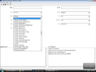

    Hey so i own a MID 729 with wm8850(wm8850-mid) i updated firmware and touch now does not work. i use fmaker and it has a bunch of touch options. any idea which one would be the right one for me? or any help would be appreciated. was a gift for someone now its a paper weight. any help please i can even send paypal money if it fixes the problem thanks

    50 views no idea? well these are my choices if anyone knows of these. $Untitled.jpg

    opened up the back says TW_M0702_V52 any ideas if not this is going to take forever if i ever can figure it out.... or can someone give me the usb driver for this tablet???

    so slowly im making progress on Fmaker(figured ill keep posting incase someone comes into this problem) i actually am having touch response now on rtp7 configuration but not focused correctly. trying different versions of these and hopefully hopefullyyyy ill get it back in running

    try other fimrware for example from MaPan MX7650B, you must here configure the .fcw file too or you can replace from the original wm8850 firmware thaht have worked for you. i have the same problem, my touch doesnt work :(

    took me till 6 am in the morning but i figured it out and then after the rom'd to the windows 8 theme :)

    thew .fwc i made was +MID7_8233_FT5306_dza710k and it used the RTP7_VT1609_DPT if you need help you can pm me and ill do my best to help
    let me know what model of tablet you have and brand :)
