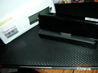

11/31 - I finally got received my ‘official’ Malata ZPAD Dock today and wanted to post for all to see. PLEASE BARE WITH ME on my review, the pics aren’t that great and I didn’t run a bunch of tests but I have most of the basic info that everyone is going to want to know. Feel free to ask questions and I will try to run additional tests for you.

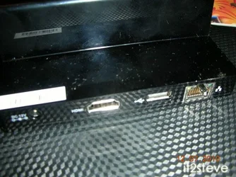

DOCK - HDMI Out, USB, LAN and power (no additional ac adapter supplied) – The quality is nice. The bottom of the dock has a rubber insert as to not scratch a table if moved around and as you may see from the pic there is a rubber insert where the tablet itself sits to protect it. The tab just drops on; pretty simple. With the ac adapter plugged in the tab does show that it’s charging. It sits at a rather upright angle (not straight up and down) so I would think that it’s something that you would NOT want to try type on without a keyboard on a regular basis, but it does seem pretty steady on there.
USB – As you can tell from the pic it did recognize an 8 GB USB thumb drive that I had plugged into it. I did not get to test a USB keyboard and mouse as the ones that I have available didn’t work natively with the tablet so I didn’t even try with the dock (yet).
LAN – Also in a pic, once plugged in the connection lights on the back started lighting up immediately. I turned off my WiFi and enabled the Ethernet in setting and it quickly got an IP and as you can see there is no longer an ‘x’ on the tablet LAN icon. I DID test the internet and all worked just fine.

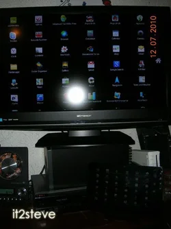

HDMI – plugged the HDMI in and hooked it up to a 32” and it popped right up. NOW the quality was grainy and I’m sure there may be a way to fix that but I just wanted to get you pics to show whether it worked or not. In the pics you can see my screen duplicated and I started a movie (which I will say the quality was much better in the movie that it replicating my home screens)
