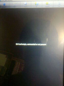

My Second Partition in my tablet is missing 1st partition is 1.50 gb and the 2nd partition 1.50 gb is missing that serves my sd card everytime i open the es file explore "sd card empty. unmounted or nor present" this message will appear

everytime i will open the es file manager the message will appear in the picture below... because of my 2nd partition is missing i'cant install other applications like Meriam dictionary, Britannica,etc My other friend suggested i need to use CWM to mount the 2nd partition? after this problem i will create system dump to have a Firmware and i will upload it :(

Most likely no one will be able to solve this for you, without seeing the device I can only guess that the sdcard partition is in an unformatted state, it would need to be formatted.

on this you could probably just switch mount points in vold.fstab
change this
# External NAND Storage
dev_mount sdcard /mnt/sdcard auto /devices/virtual/block/ndda
# External SD card
dev_mount ext_sd /mnt/ext_sd auto /devices/platform/tcc-sdhc
# External USB storage
dev_mount usb_sda /mnt/usb_sda1 all /devices/platform/dwc_otg /devices/platform/tcc-ohci /devices/platform/tcc-ehci
dev_mount usb_sdb /mnt/usb_sdb1 all /devices/platform/dwc_otg /devices/platform/tcc-ohci /devices/platform/tcc-ehci
to this and reboot.
dev_mount ext_sd /mnt/sdcard auto /devices/virtual/block/ndda
# External SD card
dev_mount sdcard /mnt/ext_sd auto /devices/platform/tcc-sdhc

vampire ive done to that no effect lols xD
do you have other solution to do this? :/
