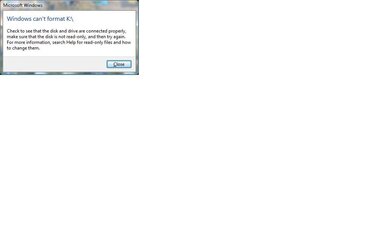

Thank you! Okay one last question, when i plug my usb cable up to my computer it says this: $Untitled.jpg
What should i do??
