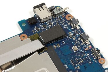

    Top Center of the picture. See the numbers 14T4 (upside down).
    The little black thing behind that silver 14T4, at the edge (top of pic) is the switch. Its no where near as big and robust as the two
    switches that make up the Volume Rocker (upper right in the picture).
    Its a push button switch. You could short it out briefly (even with the tablet open) by touching a wire or points of a small tweezer between the
    two silver patches inlayed on the black body of the switch. The button sits against the edge that faces away of that switch.
    Click HERE for all the pictures to study up what you are looking for.
    But still, if you are renting, you might just take it back and get one that works. Too much messing around inside and you might end up buying it. You have to do a significant amount of teardown to get to that part.

    Click above picture for a larger shot.
