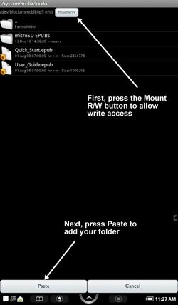

(3) Navigate to /system/media/books. Now the folder needs to be mounted as writeable. In Root Explorer, tap the Mount R/W button at the top, and the (r/o) to the left should change to (r/w). Next, press the Paste button at the bottom. Your folder should appear!
(4) Make sure to tap the Mount button again, to turn off write access to the folder.

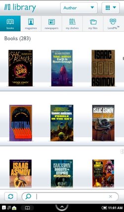

(5) Tap the soft button above the "n" key (the circle-arrow thingie), which will bring up the menu with Library/Shop/Search etc. Select Library, and your books should be there! If not, take a deep breath, reboot your Nook, and they should be there! :rolleyes: (Post back if anything goes wrong.) Depending on how you obtained your copies, some may have their original covers.

Thumbnails...hmmm. I'm pretty sure they're all embedded in our epubs. Our library started off with just epub files for each book. I tried to take a pretty screenshot...most of our books have the generic image.

Calibre has an "edit metadata" function. I assume you pick your cover, then it's embedded in the epub! (I just tested it, and it works.)
