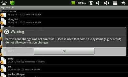

    same thing happen to me..then i try to manually change the permission
