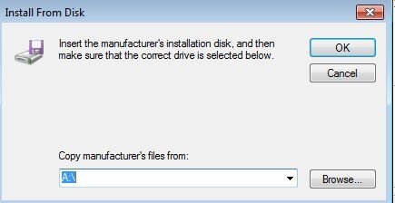

Now click Have Disk

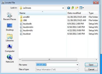

Click Browse
Find the files from LeTools you installed and Select LeDrivers and click Open
Windows should now have this next box filled in as below Click open
Windows brings you back to this window Click OK

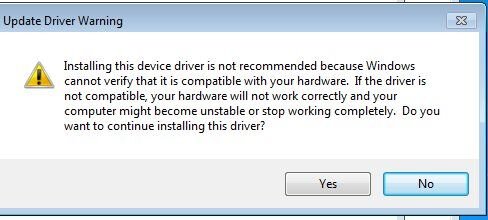

We finally get to this window where we can select Lenovo Fastboot Device and click Next
You will get this error click Yes

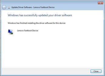

Holy crap we are finally done 100 mouse clicks later
That is finally over and we can now access fastboot.

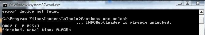

Update:
gmarkall just pm me a good tip for linux he said.
I have got fastboot working from Linux - it doesn't show up in "fastboot devices" but if you run with a custom vendor id, e.g.:
Code:
fastboot -i 0x17ef boot boot.img
Yaaay!!!
