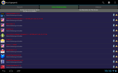

a2109a
Dec 20, 2012
90
Thanks for confirming this. There is other bloatware too. I will list it ASAP (in a few days). Annoying have been the Go-Keyboards for me, so many different ones, which I never need.
I installed:
b979e686a5845f64a4e76d53724cbb70 mcl_rom_201_for_4.1.1/a2109a_mcl0201.zip
Where are the installed apps hidden? Why they aren't listed with tree?
/install/androidins/ideapad/lenovo_a2109a_downloads/mcl_rom_201_for_4.1.1/a2109a_mcl0201

Here you can see which "bloatware" I removed. Of course there are people who use some of them, eg es file explorer. Maybe I will install News Republic. Since bloatware can be installed always from the playstore, I wouldn't care if eg es fileexplorer is removed.
