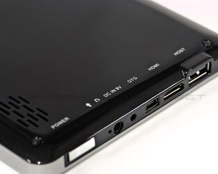

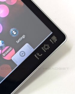

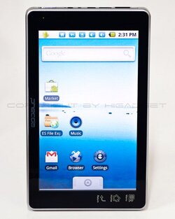

    what is your tablet, any references?
    Maybe pictures?
  3. bytayfunx
    bytayfunx Member
    Apr 5, 2011
    60
    Telechip 8902 - phecda

    Look like an X6 to me:
    And forget about recovery mode now.

    Pictures actually indicate that this is a Phecda P7, not a HSG X6. The button placement is how you tell.
    Sounds like you flashed the wrong firmware.

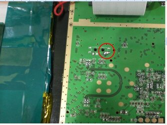

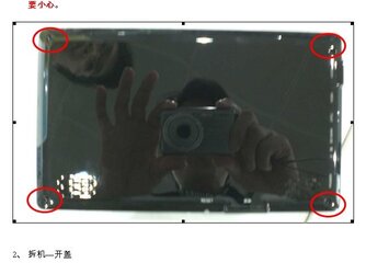

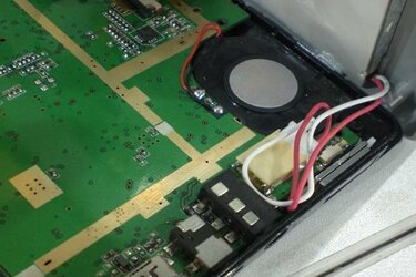

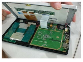

    1) I opened the rear door.
    2) The following electronic circuit, such as changes in the picture I did.
    3) I opened FWDN program. (*. ROM and *. imgadded to the program.)
    4) PC and the Tablet PC connected.
    5) FWDN program has detected that the Tablet PC.
    6) *. img *. rom and installed it. Installation is not finished completely. But the screenis no longer white. PHECEDA writes on the screen.
    7) Then I brought into the electronic circuit and the old.
    So, I canceled the circuit made ​​to combine.
    8) Then I closed device cover. Make sure the cables connecting the device alone.Cables with other pieces that will not damage the screen print making.

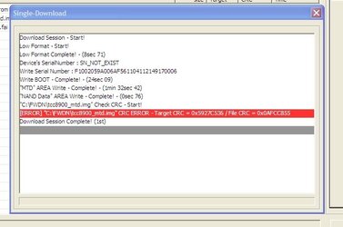

    Hi everyone,
    I wrote while I live I have taken tablets to rise.
    Electronic circuit after intervention finally had a longer recovery mode.
    But now I'm having a problem as follows.
    Another image files
    'tcc8900_mtdph.img' file when you install
    MTD area, write the complete
    Check CRC - the program freezes (stops).
    I have researched this site and XDA site. Yet I could not find a solution.
    I wonder what I did?
