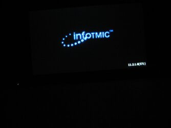

What is the Hardware Id "hwver"?
It may be listed in the Device Info in Settings or on the splash screen in the bottom right as in the example picture below of another InfoTMIC tablet.
If not in either place it can be determined using Android Terminal Emulator (no root required) and running the following command.
Code:
$ cat /proc/cmdline

Specific to Hardware Id "hwver=0.2.3.1" identified as "SVP PCT790" see this post at xda for the known InfoTMIC Update Wrap (.ius) files.
infoTMIC Hardware ID's "hwver" and updates (*.ius)
The tablet has a similar Hardware Id "hwver" to the Sylvania 7" SYTABBL7/SYTABBL7-0608/SYTABEX7-2. Only the preceding "0" is noted as "11" denoting Company Id as Sylvania. Therefore, all of the know tweaks for that tablet should be applicable. See the Sylvania Tablets forum for more posts.
Caution: Using the incorrect InfoTMIC Update Wrap (.ius) specifically, burning the wrong U0 "u-boot-nand.bin" image contained in the wrap may cause irreparable damage (brick) the tablet.
