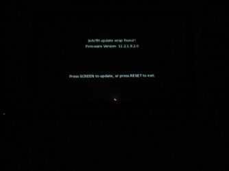

Update - Please see http://www.androidtablets.net/forum...ex7-android-2-2-froyo-using-microsd-card.htmlHow to manually update SYNET7LP/SYTABEX7 to Android 2.2 "Froyo" to confirm tablets specific Hardware Version "hwver" as this seems to determine the updates if available.

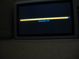

Sylvania splash screen initially displayed 11.2.1.8 (571) at bottom right and Firmware reported 2.02 but when I went to Settings and selected Update System I was greeted with Update Available.
Upon downloading (very quickly as compared to last time) the following screen was presented.
InfoTM update wrap found!
Firmware Verison: 11.2.1.8.2.0
Press SCREEN to update or press RESET to exit.

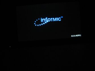

Since posting a few hours ago, I have been UNABLE to get the update to flash.

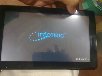

Here's the sequence - Initial InfoTM screen shows 11.2.1.8(571) in lower right.

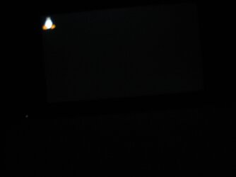

Then the next screen shows Tux, the penguin character and the official mascot of the Linux kernel in the upper left.
I go to Settings and select Upgrade system > Check updating. This displays "System Update available" and then I select Update. It downloads -

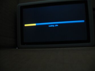

It loads -

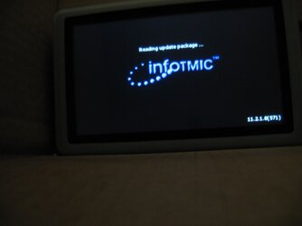

Then it unpacks - Reading Update Package ...
However, when I press on SCREEN (I assume anywhere and I've tried everywhere) nothing happens!!! Frustrating.

Interesting. There has never been firmware version in the lower right on the infotmic screen when I turn my tab on.
steevo1981
Apr 5, 2011
No firmware info located on InfoTIC screen here either. When an update is attempted I am greeted only with "Update check failed! ERR 301"
It loads -
I confirm the same. Actually somehow I corrupted the OS and was looking for some way to flash the ROM into device, when I found this way of bootable SD. Since OTG port is not working, so bootable SD card seems only solution.
When it says press Screen to proceed or reset to exit, nothing happens.
And believe me, it shows 11.2.1.8 on my tablet also.

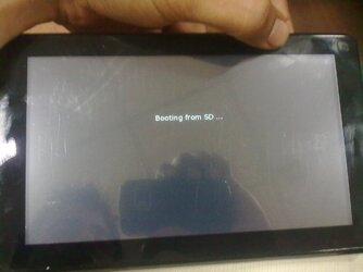

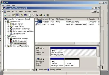

thanks for your feedback. But there are more issues in my case.
  • First, the tablet was working fine with me for few days, infact I installed those applications also which i think would not be possible and they worked great.
  • Then, I do not know why, but I installed BusyBox I think on the tablet as I already had it rooted with Universal Androot. Although I did not used or rebooted the tablet after that installation, I was playing Angry Birds just for fun. Suddenly I got low battery warning, and then it went off.
  • Then I charged it for like 1 hr or so and tried to power it on, but it used to get hanged in boot process. in the process, Infotmic screen used to appear, then Tux character at top left corner, then android prompt, and then black screen for hours and hours. after android prompt, the android animation should have come, but there was black screen and no progress. Since OTG port was dead, so as not able to do anything with it.
  • Then, I searched so much in internet for SYNET7LP, the only option seemed available to me in this case was bootable SD. so I made it with Winhex and used the firmware for Flytouch 2. I think this is the mistake I committed. Although, it burned the filesystem flawlessly, but after I rebooted it, then everything went perfect till android prompt, but after that white screen for hours and hours. no progress after that.
  • Then, I searched more and I found that there is some difference in the hardware of SYNET7LP and FLYTOUCH 2, mainly Flytouch 2 is 10" and 7LP is 7". That gave me the idea that I have burned wrong image.
  • Then I searched more, and I found the process of bruning ROM to tablet by this Infotmic way. So, I downloaded the ius for my device which is 11.2.1.8 and made the SD bootable. When I tried to boot, it boots saying booting from SD card and then it says Press Screen to update or reset to exit. How weird it is at this point, that screen does not respond to any touch, so it does not go any further.
  • Now, I am left with a brick, whose screen does not respond, OTG is dead, and does not have any OS in it.
for your reference, I am placing some screenshots.
but you know, I really liked this tablet as I was able to install whole Google Experience including Marketplace, gtalk, gmail, maps, everything quite easily with Universal Androot and few other tools.
I just hope now, somebody brings some solution to this screen problem.....

I remember somewhere along the lines reading that someone had gotten this tablet to be recgonized by burn tool by connecting the tablet to the usb prior to boot and the device would hang during the boot process and they were able to get the decive10 to light up on the burn tool. I'll see if i can find the link to that info. I don't know what you'd burn but maybe we can take the downloaded update file and get it to burn using the burn tool.
I see where you said the otg port was dead. Have you tried to power the tablet on with the usb connect to a computer? the tablets when they 1st shipped people thought they had a dead usb it wasn't it simply wasn't turned on in the os. Try booting it with the cable connected and using the windows xp instructions at the below link.
http://www.androidtablets.net/forum...d-2-2-froyo-using-microsd-card.html#post72565
xandercage
Apr 7, 2011
@ bigwooly
I have tried the same that you said. connecting the cable between OTG port and PC without powering on the tablet. after that when I power on the tablet, nothing happens. so, that is how I concluded that OTG port is dead, although my host USB is working as if I connect a keyboard through it and press CTRL+ALT+DEL, then it reboots the tablet.
So, do not know what to do now.
