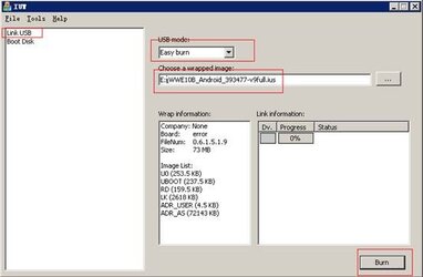

1. Burning by OTG
1). Open the IUW burning tools and select Link USB
2). select Easy burn
3). Select the ius .iso file
4). Connect the the tablet to computer
5). Press Power+Menu to boot the 10 inch tablet and Power+Voice+ for 8 inch. When the small box in Tool turns green, press Burn.
6). After burning finishes, plug out the cable and press Reset, then restart the device.

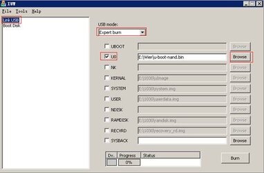

4. Buring of Uboot
Get the OTG tools ready, u-boot-nand.bin files for 10- or 8-inch tablets; connect the devices and open the IUW software as follows:
When the box below DV turns green, click Burn. The burning doesn’t finish until the progress reaches 100%.
Warning: Keep the tablet is charging because the whole burning progress needs definitely enough power, otherwise the system will break up and booting fails. After burning finishes, the system will starts self-checking. It is normal when the flash- or blurred screen appears.
