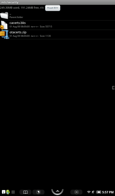

    Yes you can use Root Explorer to disable auto updates:
    -Go to folder /etc/security
    -rename otacerts.zip to otacerts.zip.bak
    I haven't made this change myself since I want my auto updates but other have said it works for stopping your NC from being auto updated.
    note: updates as of now on remove root, they do not wipe or reformat your NC. It only replaces the system folder of the operating software.

    Does disabling OTA updates by renaming the otacerts file also disable the updates/notifications from the Android market? Or does it only affect the OTA updates from Barnes and Noble?

    To my knowledge, and I have not read anywhere, that remaining the otacerts file has any affect on the updates from the android market. I'll try to keep an eye out and let you know if I find otherwise.

    Has anyone had success with this? I've just tried and I get a "Sorry, operation failed" message.

    I have done this renaming ".bak" method. I haven't received any ota update yet and my market is working fine. When i go into to market and click downloads it shows the apps that have updates.

    You are mounting as r/w in root explorer before you rename right? Remember change back to r/o (read only) when done.

    Apparently, here are several examples of renaming otacerts.zip not working. Also, modifying build prop isn't guaranteed to work.
    Noone is sure of a failsafe method yet. If you can keep WiFi off & still function, a solution should be available soon. Then we can wait for a 1.1 auto-nooter.

    I should add i have clockwork recovery which will block the update too i believe. But i don't want to get into that again. I am prolly annoying people with all my clockwork talk today.
