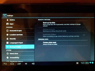

I have 2 Zeki Tablets and I cant understand why 1 has a recovery mode and the other does not. I checked the about tablet and all the information matches. See picture below. Is one rooted and the other is not? Why the difference?

It is possible to be rooted but not have a custom recovery installed.
TaekwonBo
Nov 20, 2012
31
Whats the difference with the Factory Data Reset and Recovery mode (which says "can clear data or system upgrade")

I have 2 Zeki Tablets and I cant understand why 1 has a recovery mode and the other does not. I checked the about tablet and all the information matches. See picture below. Is one rooted and the other is not? Why the difference?]
Those pics has nothing to due with root, that is just your firmware one allows you to boot to stock recovery the other one doesn't. You don't need root for the option to be shown. You just have different software.
