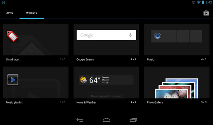

Finding for screenshot??

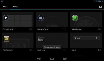

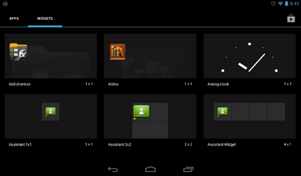

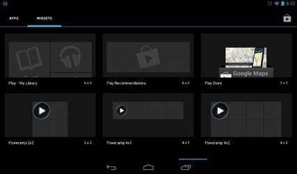

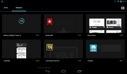

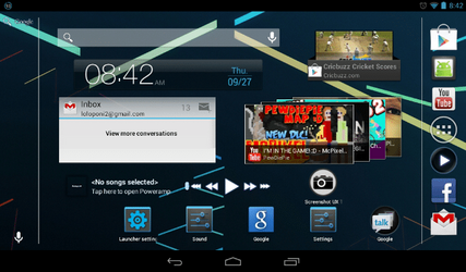

Screenshots!!!!!!!! Bros
