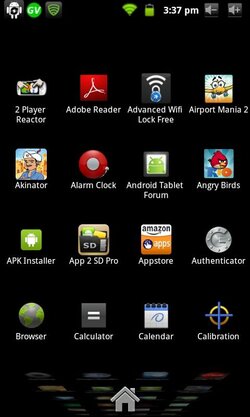

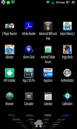

When I change the screen density the app menu is fuzzy and doesn't look good any fix for this? $1.png

woah wtf. Are you changing thru build.prop. Also it looks like you are using a custom font did you make that in kitchen? You should change your font back to stock
Yes I am changing through build.prop and I did not change fonts this is what happens if I change it to 160 While 200 looks fine.
200 is the one to the left and the right is 160.
View attachment 4152 View attachment 4153
I just figured out the problem. The stock launcher for some reason makes the app drawer look horrible. To fix you would need to use a different launcher. I use launcher pro as seen in my pics ill upload a 160 dpi picture with lp's app drawer
http://dl.dropbox.com/u/40525714/20111005045207.jpg
http://dl.dropbox.com/u/40525714/20111005050835.jpg
