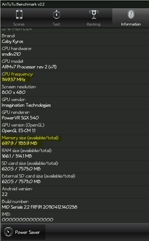

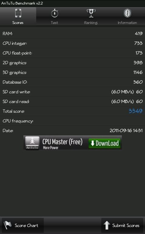

Custom Firmware for 7024 Base on Official 7024 firmware of Coby!
***Please note i customise my firmware base on what i want and how i use my tablet. I am not responsible if something bad happen to your tablet... This is also just a hobby.. please dont be mad at me if you brick your tablet..well if you dont like you can always flash the OFW Firmware.***
***I dont know the long term effect of overclocking the cpu...this is a warning!!!***
****Before flashing a new rom...always use Titanium Backup so it will be faster to restore your application after every flash of rom!!!**
Now Pictures first
My New Bencmark
My Old Benchmark without any tweaks
My 7024 Info-Take note of my Internal Application memory
Change Detail:
Cpu 998Mhz to 1149Mhz
Application Storage 486.4Meg to 1133.9Meg (Install all the application you want!!!)

flxrms
Developer
Mar 23, 2011
365
52
Hello i'm Brazillian sorry my english...
Your cfw is working everything? Hdmi, volume and soft buttons? Did it have market?and the calibrate app? Thanks for your cfw
Sent from my MID7024 using Android Tablet Forum
Well its base on the official firmware so everythings working. It also have google market.
Its working with everything plus more actually.
Sent from my Coby Kyros 7024

Thank you flxrms,
i am trying it now. it installed okay. it is quicker. first thing i did was to go to 'superoneclick' to get root. that worked too. now the market is fighting me. it mostly does not work ( download ). my first and most important task to to use 'titanium backup' to restore the fourty odd little apps. i tried to install busybox and it stays forever on 'please wait' ( stuck ).
trying to think what it wants and needs next. i installed 'rom manager' and then i tried to do a 'fix permissions', and it does not do any fixing ( stuck ).
well i think this coby probably needs a slower clock. where do you keep the 'clock down' version ?
....the titanium restore worked. i was sweating it out to see if it also would develope freeze ups. none there !
.. AnTuTu bench mark just force closes, no runny, no way, no how.
. LinPack benchmark works and runs. it gets a 16.3 MFLOPS
Opera Mini force closes
rain
May 5, 2011
95
10
maybe your system cannot run with the faster clock ( fifteen percent boost ) ? ? ?
