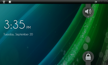

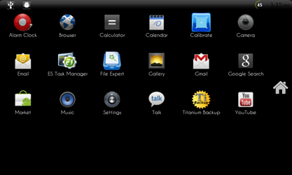

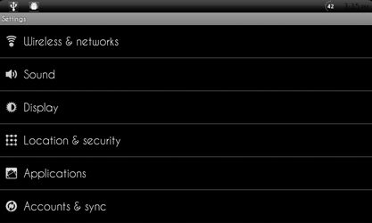

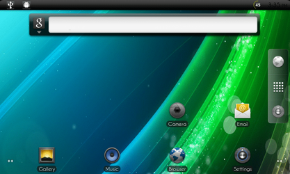

So since we are sharing this is what I build for my personal use but if anyone wants to try it out be my guest :)
this is my peppermint rom
$device-2011-09-20-133230.png$device-2011-09-20-133244.png$device-2011-09-20-133251.png$device-2011-09-20-133302.png
Changes: Nothing big really
Based on Official 7420
Lots of changes regarding the install process I hate how coby flash one thing over another
Custom logo
Custom theme (UOT)
Battery with percentage
Google search bar replaced with a black one
Changed default wallpaper (hated the other one)
Custom font
Removed most of the STOCK apps.
Google with old market
Use SuperOneClick 2.1.1 to root (I spend almost 3 full days talking with people for forums and IRC, attempted almost 10 different ways to root this thing by default and couldn't do it :( )
LCD density changed to 180
Why old market?
Well I'm from Costa Rica and I used to have the new market but it appears that they implemented some checking on the apps that you can download for example with the old market I can download and install Astro file manager but with the new one I can't
And to be honest I like the old one better :p.
I guess that's all
Same as usual
This is something I build for my personal use and works perfectly on my device, that does not means is going to work on yours, you are fully responsible of what you do with your device and by downloading and installing you take full responsibility of what happens to it.
Known Issue
The clock on the status bar has black text, is hard to see but it is there.
I'll try to fix it when I have more time :p

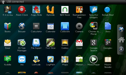

oh and a little tip
I did not include it but since the LCD density is changed you should install ADW, that launcher lets you play with the number of rows and columns on the drawer and the home screens so yo can end up with something like this:
