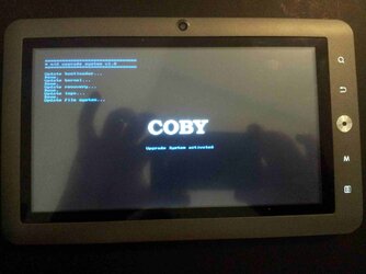

I uploaded the image where it hangs. I've used various ways including SDformatter but still the same thing. It hangs at this stage.. Can anyone help?
I am newbies to this. Currently, my MID7024 would only power up and display "COBY" and went off, leaving only menu button lights on. I've read the forum and noted that this new update may help me to revive my 7024. But after I follow all the instruction within the official PDF, my MID7024 seems to be updating, but halted.. Following is the screen that it has stay on for hours without any progress
Update bootloader...
Done
Update kernel...
Done
Update recovery...
Done
Update logo...
Done
Update File System...
Then the 7024 just stay as such for hours. Initially I thought the update will take long time, but even after 24 hours staying on also the same. I figured there must be something wrong. Can any good samaritans help me??

Sorry I wasn't able to help you. Don't lose hope, keep checking this forum and hopefully some of the developers will be able to help you.
