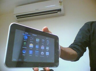

Hello,
I have an Allwinner A10 based tablet, from NXG electronics $2012-03-31-185508.jpg
I need help in rooting this device. I have tried using the Aurora Market fix. It did not work.
First off, the command adb devices recognizes the device with id as "????????????????" and it says no permissions.
Any kind of help is appreciated!
