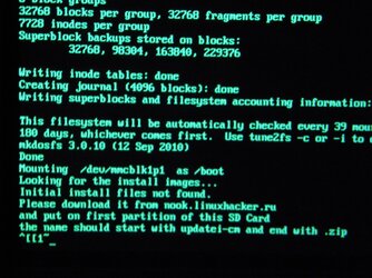

JE Garrison
May 12, 2011
7
this is my new issue
Spider
Mar 24, 2011
15,785
1,813
Start with a clean/formatted SD card in your PC.
Go to [RECOVERY] Making an updated bootable ClockworkMod SD - xda-developers and follow new instructions 1-5.
The files referenced in step 2 and used in step 4 are attached at the very bottom of the post.
When step 5 completes, make a backup of your stock 1.2 nook. (You never know when it might come in handy.)
You now have a flashable CWM SD card and a backup of your system. Put the card back in your PC
Next, go to ManualNooter 4.5.6 (For Stock 1.2) - xda-developers and begin at "Let's get started".
Follow the instructions from there and your nook should be successfully Rooted.
