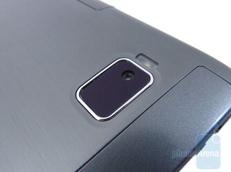

On the back of the case, on top and to the left of the camera are 3 small holes that don't seem to correspond to anything... could be that the Mic is behind those, maybe in the SD slot area.
Where on the device are you referring to?
Picture borrowed from this Excellent Review:
http://www.phonearena.com/reviews/Acer-ICONIA-TAB-A500-Review_id2731

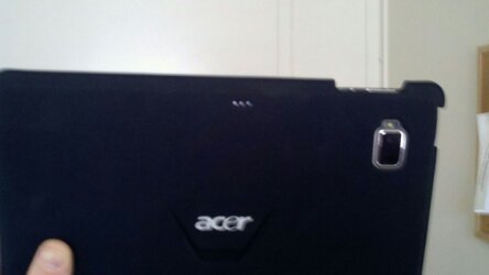

I tried to take a picture but its not coming out.
Basically, when holding in landscape and viewing from behind, so the camera is seen on the top right. Almost halfway but not exactly, on the top, are 3 small holes in the case.
Through the holes, nothing is on the unit except the rightmost hole is over the leftmost part of the SD cover.
Hope that helps explain the holes. Wish my camera was easier to get the photo posted.
dan776
Apr 27, 2011
151
8
This is a poor photo, hope you can see what I'm referring to.

The Three "holes" might be for a charging dock - the Motorola Xoom has similar holes:
EDIT: No, I'm crazy the dock fits on the bottom DOH! But now that I look closer, the middle hole has a little slit in it - I think Dan776 is correct - those are the mic. That would make more sense now for the case design.

Guess its possible.... the dock connection is way on the other edge of the Acer though. Just seems strange that they are in the case, when nothing corresponds to it in the actual unit. All of the other openings have an obvious purpose.
EDIT. the slit you are seeing there, is the cover of the SD card compartment. The Mic has gotta be in that compartment... otherwise I think the test recording would be much more muffled.
Icebike
Apr 28, 2011
1,523
186
Good EYE!!.
If you open the SD compartment, looking at the A500 from the Rear, there is a small hole in the lower left corner of the compartment.
This is undoubtedly the Noise Cancellation mic. And it's location perfectly explains why JoeRnCT had such a problem trying to record a video using the Front Facing camera while speaking from behind the Tablet (see Post #4 above).
The Cancellation mic was over powering the main mic, and cancelling his speech as if it was background noise.
