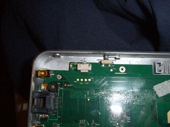

  2. leeb
    leeb Member
    Jul 16, 2011
    463
    21
    87
    I have it completely disassembled right now, trying to decide if I want to pull chips, since it will not complete an installation now...
    and,
    the CPU shows
    imapx210bm1-80
    How could that possibly be a 1GB cpu when it obviously is 800?
    It looks like even finding the NOR flash for this thing is gonna be a challenge...
    The only source Ive seen lists an 800 (not 400) and Im VERY leery about expanding the capacity when I no NOTHING about the memory map on these beasts...
    The 'replacement' unit should be arriving in a couple of days... hope its memory is better!

    Up until last nite the 'new unit' had a non-functioning touchscreen...
    Here is why...
    SOMEBODY (and not ME) solder-bridged the ENTIRE connector...
    Probably thought Id get software loaded, find the hardware was broken, and demand to send it back with software installed...
    But... they dont know me very well....
    Never know, huh?
    :D

    60
    NULL
    Jeez! Why would someone solder-bridge an entire connector? o_0
    And what would they gain from you returning it with software installed?
    It pisses me of seeing people being dishonest while selling stuff on ebay. -_-''

  8. leeb
    leeb Member
    Jul 16, 2011
    463
    21
    87
    WHY?
    Ineptitude. Didnt you read the title? LOL
    No, I dont truly BELIEVE the guy planned to do that... thats just my paranoia talking... What I THINK happened is:
    Someone opened the pad, broke the connector 'hold-in' piece and attempted to remove the connector.
    Made it worse (likely with a sledgehammer for a soldering tool) and sold it as 'software defective'. THAT was his mistake. If he had said ANYTHING about the touchscreen not working also, I wouldnt have started a case against him.
    Ebay got him by the skruff of the neck (I guess, lol) and told him to make it right. He wanted a return for a full refund.
    By then I had found this and gotten it working, so I said 'UH unh... I dont think so. I have successfully repaired the SOLDER-BRIDGE damage that had been done and I do NOT intend to return the unit now.'
    Suspect it got him in some hot water with EBAY tho... as it should. FULL DISCLOSURE is the ebay seller's friend!
