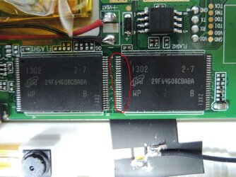

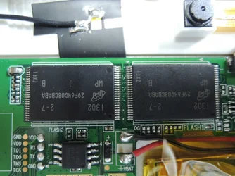

    Dear All,
    i tried to open the tablet, in order to unbrick it, and tried to bridge some pins (as the photo of "umar_fiaz" in Unbrick ONDA V811 (100% working) but failed, mine is V811DAD3V7A00865, please help in locating the TF-boot pins.
    also please confirm my understanding of how to unbrick the tablet:
    1-) open the tablet.
    2-) connect it to XP through the USB cable, and open the device manager in order to check if XP can detect the tablet (at this moment there will no any response...)
    3-) bridge the TF-boot pins, and while this press Home and Power together, the device manager should detect it now, after detecting, release the pins.
    4-) now it should be ready to re-flash again using suitable firmware using a USB flashing tool.
    please help me in this problem
    thanks in advacne..

    hi Emran,
    your device is onda v811 v7 which is different from v1 to v6; I suggest you to try these pins
    may it works :)
    regards

    Dear umar_fiaz,
    thanks for your reply, actually, i managed to fixed it, i realized that my NAND flash memory chip is different that what you have, look to the attached photo, i found that those are the TF-boot pins, now it returned to life again... View attachment 10903
    i hope this photo will help people who are facing the same problem...
