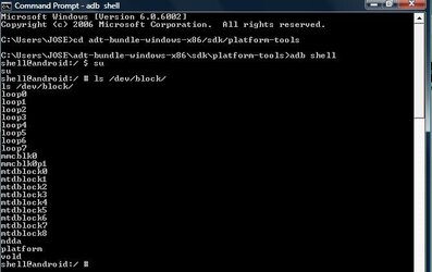

  1. thehandofdoom
    thehandofdoom Member
    Dec 24, 2012
    17
    62
    quito
    coby MID7048-4

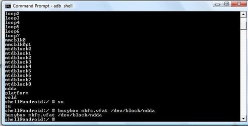

  2. thehandofdoom
    Dec 24, 2012
    17
    62
    quito
    coby MID7048-4
    this is the result

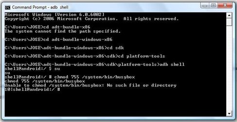

  3. vampirefo.
    vampirefo. Senior Member Developer
    Nov 8, 2011
    3,836
    1,394
    655
    Huntington WV
    Leagoo Lead 1 ZTE OPEN C, Coby 7065, Coby 8042, Coby 9740
    looks like same result as OP.
    adb shell
    su
    ls /dev/block/

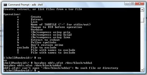

  4. thehandofdoom
    Dec 24, 2012
    17
    62
    quito
    coby MID7048-4
  5. vampirefo.
    Nov 8, 2011
    3,836
    1,394
    655
    Huntington WV
    Looks like command should have been
    busybox mkfs.vfat /dev/block/ndda
    not
    busybox mkfs.vfat /dev/block/ndda1
    My bad.
    adb shell
    su
    I no longer have the device and was going off my notes, the 1 is the mount point, not the partition again my bad on that.
    Should work now.

  6. thehandofdoom
    Dec 24, 2012
    17
    62
    quito
    coby MID7048-4
    this is the result of the second method......im reeboting manually later i report the final result $and5.jpg
