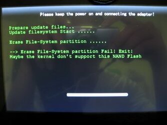

    irobot after flash rom "maybe the kernel don't support this NAND flash" attachment picture
    what is it
    help me. thank

    it's build in nand flash issue you have currupted or damage nand flash

    eken m001 and flytouchONE265
    i have the same problem
    when i get a firmware thats not compatible with t he pad
    when i got a firmware thats compatible then there is no problem
    so i would say find a new firmware for your pad this one is not working

    i flash rom ePad_android16_WMT2.1.1_Factory_Rom.7z. it can boot but thouch screen can't work.no sound.can't camera.can't wifi.
    where i would find firmware is working. can halp me.
