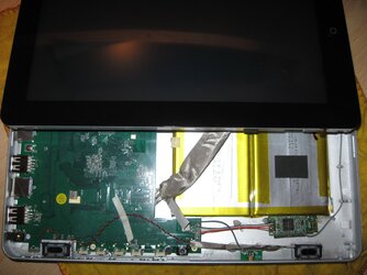

    Well - i'm getting increasingly fed up with this tablet - today i took the bull by the horns and opened it up (4 screws under the plastic caps - 1 at each corner) - then working from the front - run a thin knife down each edge and lever the screen off - take care around the reset button as there is a tiny ribbon cable there) - anyway - i disconnected the annoying buzzer motor (just unsoldered the red lead). also noticed that my camera was loose so refixed that also. - cant find the orientation sensor - dont know what to look for - is it a chip or is it mechanical - will have to do more digging. - Put it all back together again and tried to power up - would not start..... - started to unscrew the 4 screws again and noticed that the screw hole in the corner closest to the wifi switch did not line up with the tapped hole (by about 1 mm) - in order to put the screw in i had to press the body together to align the holes. Left the screw out and tried a restart - worked first time. - i will leave this screw out for a few days to see if it helps. - in the mean time i will keep looking for a solution - if anyone knows how to disconnect the orientation sensor please let me know.

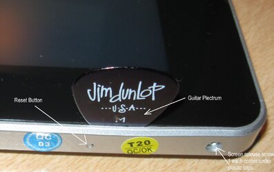

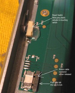

    Latest update - today my tablet failed to start again so, after a few choice words...., i investigated further - this time i could not get it to start even if i put the tablet in the horizontal position and pressed any combination of buttons (see my previous posts). one thing that i did notice was that whilst holding down the power button and pressing the reset button the screen flashed on momentarily (only happened once and could not reproduce) - i then used my finger nail to prize apart the case by the reset button and pressed the power button - Bingo the tablet started - i removed my finger and the tablet shut down. Next step as a temp fix i inserted a guitar plectum in the same place as my finger nail and tried again - started first time every time - i am now thinking that the plastic reset button is catching the reset switch inside (this sort of answers the question why my tablet would not start when in the vertical position - the weight of the tablet would have been pressing on the bottom of the case / reset button etc) - i have attached a picture of my temp fix so that others with the same issue can try it - any piece of thin plastic should do (credit card etc) as a temp fix.
    Next step is to open up the tablet again and see what i can do to fix this - i have ordered 2 micro speakers (mobile phone inserts) from ebay to see if i can improve the awful low volume so will attack the reset issue in a couple of days when i try these.
    Hope this helps everyone with the same problem - let me know if it works for you.

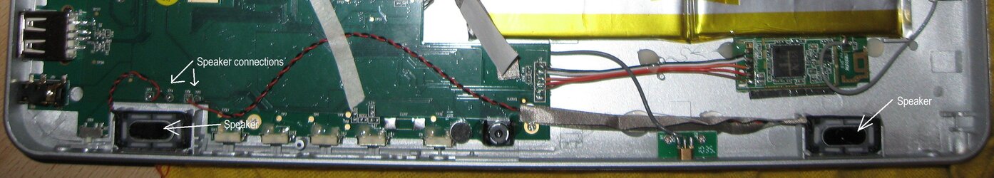

    Last update on this issue - Speakers arrived - opened up the tablet (see attached pics) - replaced speakers - no sound at all from the new speakers (need to do more investigation into speaker type (any one interested the size of the speakers is approx 20mm x 10 mm x 3mm thick) - i think i have some old laptop speakers which i can try) - replaced the original speakers (note that they have to lie flat as they are too wide to stand vertically) - anyway my real reason for opening up the tab was to check out the reset switch - sure enough the grey plastic actuator was touching the actual reset switch - removed the actuator , used a nail file to remove about 0.5 mm of plastic and replaced - now i have a fully working tablet (and i can play my guitar again).
    By the way in one of my previous posts i mentioned a small ribbon cable by the reset switch - this is held in with a small plastic clip - slide the grey piece towards the centre of the tablet this will release the ribbon cable - when reassembling the tablet - insert the ribbobn cable fully then slide the grey piece back into its original position - the attached picture of the reset switch shows this clip.
    If i ever get around to replacing the speakers i will post again.
