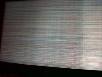

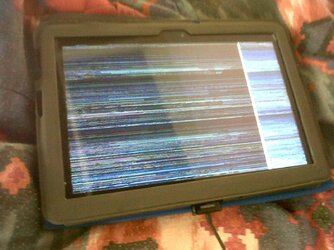

Hi,
I'm Devin Singh.
I have bought a Samsung Tablet GT-P7510 32GB with WIFI in August 2011 from BESTBUY in Tampa. I have a problem with the screen,
The screen starts to flicker,dazzle and get distorted till you can’t even turn it off, you can’t see anything.
I need some help in this matter.
Devin
This problem

I just got my galaxy tab and when it goes into sleep mode it flickers the screen not as bad as you pic were showing but i think you should call 1800samsung and if you have aa warranty they should be able to help you i might do the same if the same problems occurs more.

Try pressing the power button down until the tab turns off and restarts wait for 10 to 15 minutes to see if it clears up
If not you might need to do a factiry reset. Turn off tab the press power and volume down at the same time. It should boot to two icons. use the volume down to select the left icon then press volume up. Select wipe/data or factory reset. Then reboot.

just update to ICS
i used this flash to solve my problem
P7510XWLP3_P7510OXXLP8_SEB
