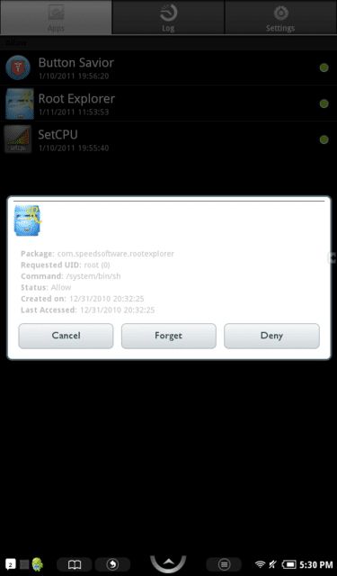

  5. rico2001
    rico2001 Senior Member
    Dec 8, 2010
    1,599
    264
    222
    Charlotte, NC
    NOOKcolor
    Yes rooting has nothing to do with if Root Explorer will work. It's all about SU giving permission (allow) and the right version of Root Explorer (2.13 or higher) installed.
