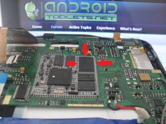

is only true copy of the internal SDcard not help solve the problem of bricks tablets
Yes. That´s because the 1024 has another NAND: SAMSUNGK9F1G08U0B PCB0. This NAND can works like a boot sector and backup for restoring the system or something (Press Power + Back remember?). I think that NAND can be corrupted by the wrong update. (see photo below).:p

pimentell
Apr 17, 2011
17
Well there are a couple of methods to recover the NAND.
One, which may be too advanced, is to see if there is a JTAG connection on the motherboard. Then you have to connect
a JTAG interface and reflash the NAND with a known good NAND that was pulled from JTAGing another working device. From my experience you
may run into to both devices containing the same ID info such as device serial number etc. Maybe I should start a recovery service and
charge to do this. But I don't have time for all that right now.
The other is a method that I've been reading on another forum for another tablet that I own.
What they are doing is using the Linux dd command to read the NAND partitions and reflash the NAND. Again you
would need uncorrupted images of the NAND partitions.
I know that, but i cant´t see any JTAG pins on the 1024. Linux dd command isn´t possible because the tablet is "dead". No connections is possible. The only solution is remove the NAND, reflash it with a universal programmer and solder it back. I can do that but i don´t have the original image. Maybe if i buy another to copy it, then we´ll help others with the same problem. This method can unbrick all tablets ARM 11/A8 Based or TCC8902, iMX515, HSG X6 and more...:eek: Below is the universal programmer and the adapter for the TSOP48 NAND...
