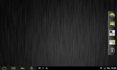

Unofficial CM7 KK Edition Beta 3 Highlights
- All the goodness of CyanogenMod 7 such as ICS rotation
- Working touch screen
- Working sound
- Working wifi
- Working g-sensor
- Video hardware acceleration
- Fixed unable to turn off while charging.
- Market v3.4.4
- ICS Fonts
- Added KK Quick Control(Volume control and Invert Accelerometer X/Y to suit different games)
- Longpress Menu key to activate KK Quick Control
- KKMod Device Identity Tweak to improve game compatiblity(come with Galaxy S2 profile)
- KKMod Enable 3G Tweak(Phone and TelephoneProvider apk is disable by default. This help to save battery if you dont required 3G)
- support P76ti Revision 2(Newer version of tablet)
- Working external SD
- Fixed CM Screenshoot
- update Market to v3.4.7(Google Play)
- Working USB Bluetooth support
- Working USB 3G support(tested with Huawei E1782)
- support S2E and bundled with rom
- Partial working HDMI(can output to TV but video and sound not support not working as yet)
- Allowing swapping of internal and external SD in Cyanogenmod settings
- Allow 4 more levels of dimming the display

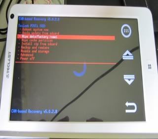

Installation Steps
- Download P76ti CM7 ROM from below and copy for tablet internal sdcard
- Boot into CWM(install ROMKit apk if you do not have cwm installed)
- Install zip from sdcard and select the update-p76ti-cm7-xxx.zip
Files
Unofficial CM7.2.0 KK Edition for P76ti Beta 8 ---> HERE
Touchscreen patch for revision 2 tablet ---> HERE
KK Romkit v1.10 bundled with Clockworkmod v5.0.2.8 R2 for P76ti ---> HERE or HERE
Note that this CWM is meant to be use for upgrading CM7-KK beta rom so many of the features are not tested. Feedback are welcome and bug is to be expected.
