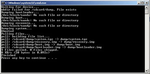

Having seen that you are requesting firmware dumps, I tried to dump my own, but with no luck. I've tried the dump instructions here: http://www.androidtablets.net/forum...mps-coby-generation-3-devices.html#post205970, but I get errors (see attached).
So, firstly, how can I dump my firmware for uploading to this forum?

It's no surprise my dump utility doesn't work, given that the system structure of Generation 3 and 4 tablets are totally different and the tool is intended for Generation 3 tablets. To the best of my knowledge there is no dump process for the Generation 4 tablets. Look in the Generation 4 Technical forum as there may be a root procedure there.
