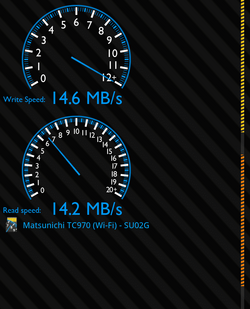

$matsunichi tc970 (wi-fi) 2012-03-02 18-37-06.pngOK, so here's the deal. I have attached a pic of the results from the 2 GB SD card that came with my Le Pan TC970. Crazy, right? I am now convinced that I just got super lucky with that card and don't think I will be able to match them on a 16 GB card on the cheap (the 2 I tried both came in at under 10MB/s). But I also found out that I don't really care as I believe that a 7-8 MB/s write speed is just fine and is not actually a significant bottleneck for the tablet. I tried partitioning - no change in speed. I did some additional testing and I think my original speed issues were a total result of weak WiFi signal while testing. The antenna on the Le Pan is not great, but will do for my needs and so will the SD card I ended up with - a Amazon Basics "class 10" (yeah, right) 16GB card. Anyone else get a crazy fast card with their tablet? I would also be curious to see if people have gotten over 10MB/s with a big card and the if results I that I got were just poorly manufactured/mislabeled cards. Cheers.
Original:
SD Card Brand/size: Default card - 2GB
Rated Class: ?
Write Speed: 14.6 MB/s
Read Speed: 14.2 MB/s
Tablet Model: Le Pan TC970 (not rooted)
Upgraded:
SD Card Brand/size: Amazon Basics 16GB
Rated Class: 10
Write Speed: 7.8 MB/s
Read Speed: 15.1 MB/s

Thanks, MrFurius,
The Le Pan provided 2 GB card is a fast one indeed. You got the best cookie in the jar it seems. :)
Class 6 and higher work, and Class 10 seems to be hyped by many manufacturers - buyer beware, test your speed.
