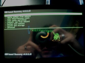

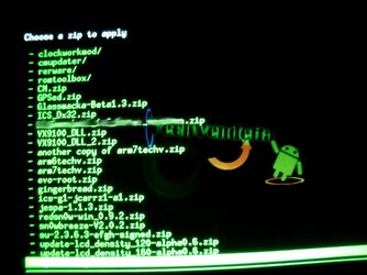

CWR for infotm(ic) / Sylvania:
Hey look, I actually finished it:
NEW FEATURES:
No more need for an external keyboard
Fixed the warnings and mount issues
More ui candy
Background code for ota updates (in future)
various other small tweaks
Here's the new recovery ramdisk: recvrd_32712 - Minus
Flash it with iuw as RECVRD.
If you cant find the button combo for your model to boot recovery, then you need to root it, install a terminal and type su [enter] reboot recovery
Tested on Sylvania 7" (sytabex7) and iCan 10"
sdbootable method coming soon for devices that lost otg mode.
Screens will be up later today.
Enjoy.

I think I am missing something, is this a new ROM? I just get the option in your first screenshot but it does not find the .zip file.
Thanks for all your time and hard work.
