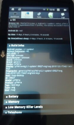

Disgo 6000 about device info
Model Number
Disgo 6000
Software version
1.1
Kernel Version
2.6.32.9
Build Info / CPU and Sensors from Android System Info attached

remoh That screen shot shows they are the same board which pretty much verifies my above theory. If anyone wants to downgrade back they can follow what I said and probably get cwm and which ever system.img they want via expert flash.
