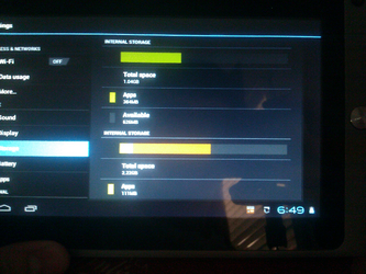

Oh my freaking chicken nuggets, that was a lot of typing. Corrections made and thread updated.

Are you able to access the internal memory (the memory used for storage not for system)?
You should have about 2.5 gbs left because the lk.rom file that you flash from my zip expands the app storage but shrinks the internal memory.
To make sure you can use the internal storage go to settings (in the rom you are using) storage/memory and it should read something like my preview.
Btw this only affects the storage and leaves the rest intact. The CM7 rom that you flash has some things not working. You should be able to flash the ics update that we have in these threads. I have the newest one with gapps but I need to fix several things first before I upload it.

Verified, Same storage specs as you.
