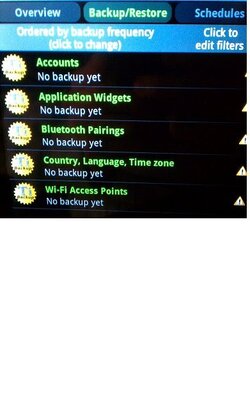

:confused: Okay I JUST about have this tablet worked out perfectly. I figured out that I had to install busybox and restarted my tablet just to be certain but still no apps on the list.
Can anyone help out? Thanks!

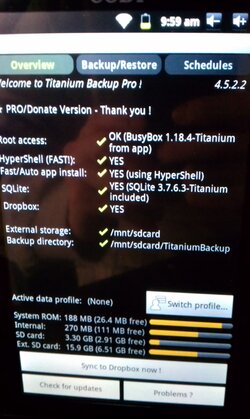

MIDx024 comes with an old version (1.16 IIRIC) pre-installed. I didn't install busybox and I could see all the apps, you can try uninstalling busybox and try again.
In the TB Market Page they also say that a minimum or maximum busybox version is recommended, did you check this out?
If you are using link2sd or something like this to move your apps besides the normal app2sd thing it may also cause a problem...

You need to be using busybox from system NOT from titanium backup. I see you said you already installed busybox, if you did this seperate from titanium backup then just go to settings (menu button) in titanium backup and choose "Use system busybox"
