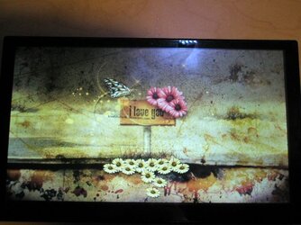

Hey! I am trying to see if I can figure out who made the kernel for my Android/double DIN car radio bought from Hong Kong. It is also known as the Car/Droid as well. It basically has a removable tablet as the front of the radio. Great idea, but poor performance.
It looks to use the TCC8902 development board with 8gb of NVram, and Android 2.1. I get no help from the seller of course, so wondering if anyone knows this graphic image that comes up when it boots. Maybe that can help me to tinker around in it.

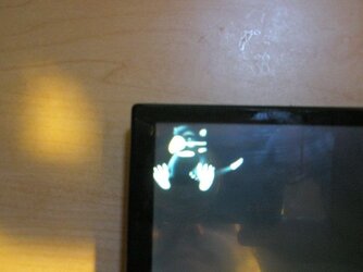

I posted the first boot image and then a small graphic which comes after that, some rodent or something??
