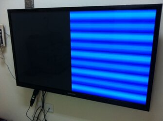

I have ug802 dual core google mini pc it was working good but I change the sitting in the for Screen Resolution than I can not get any picture or some time I get have blue and black screen.
I see that there is blue color inside the stick but no display on the plasma screen but there is message says Not supported resolution.
can you till me how can I get it back working even by reset it.
Plz help

but I am running it on Samsung plasm 51" full hd
here is a picture of it half black half blue
Is there any way to reset the stick and make it factory setting?

ali132011
Nov 6, 2012
I did as you says but nothing change same display half blue & black
Give me reset method if you have it
