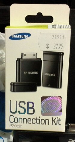

I have the USB Connection Kit P30pin which supports USB FAT32. I have plugged Thumbdrives/sticks/jump drives into my NOTE which has a specially adapted interface setup -simply touching the USB symbol (next to the clock) unmounts the USB STICK. The NOTE has USB Hosting functionality as stated in the manual, but looking at USB Connection Kit the info pamphlet say it supports FAT32 max of 32GB. So it must be this adapter and not the tablet!

The following is an email from Samsung Support:
Thank you for your feedback. We appreciate the time and effort you have taken to provide it to us. Unfortunately the Galaxy Note 10.1 is not able to connect to external hard drives and is not designed to do so.
Please also note that the Note 10.1 also does not support the use of a USB.
Well that is a load of codswallop. I bought the USB Connection Kit and it works. It is even on the accessories list for the NOTE on their website. Have a look at the pic I uploaded.
Surely you can't be serious, Samsung.
